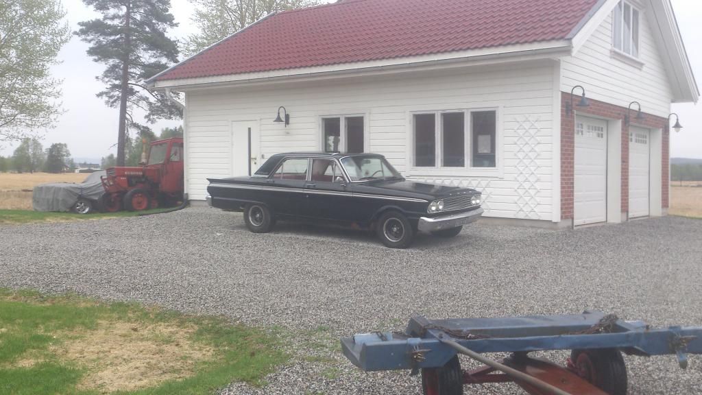

This was the sight that greeted me as we rolled up the driveway. It was in need of some cosmetic work, but nothing I hadn't counted on. The interior was a bit shabby, but it wasn't bad. It needed a new ignition switch, headlight switch, seats recovered, headliner fixed and on further inspection it needed some rewiring done in the dash.

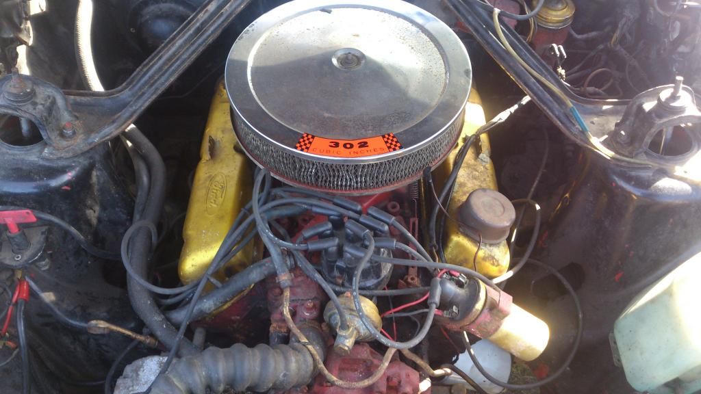

The shifting problem I discovered to be the shifter on the column had been shortened a bit too much. And the engine had several minor issues, most of the spark plugs were shorted out, the Holley carb had a blown power valve and the timing was off.
I pulled the shifter from a Falcon column I had lying around. And ordered a new two barrel Holley 500cfm.

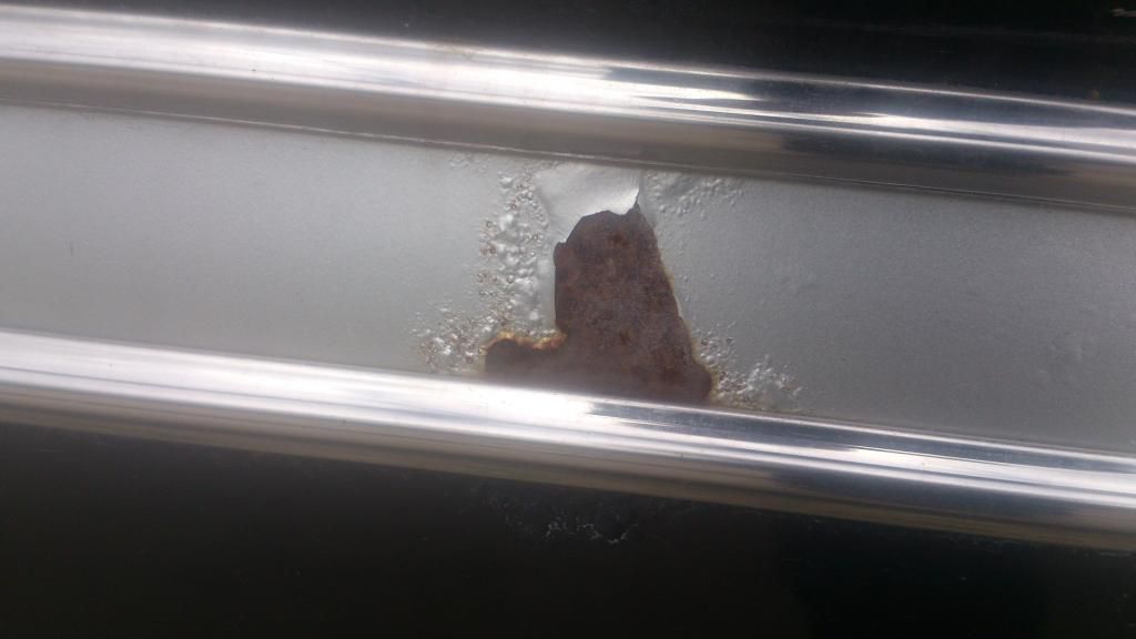

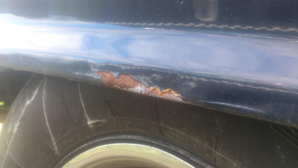

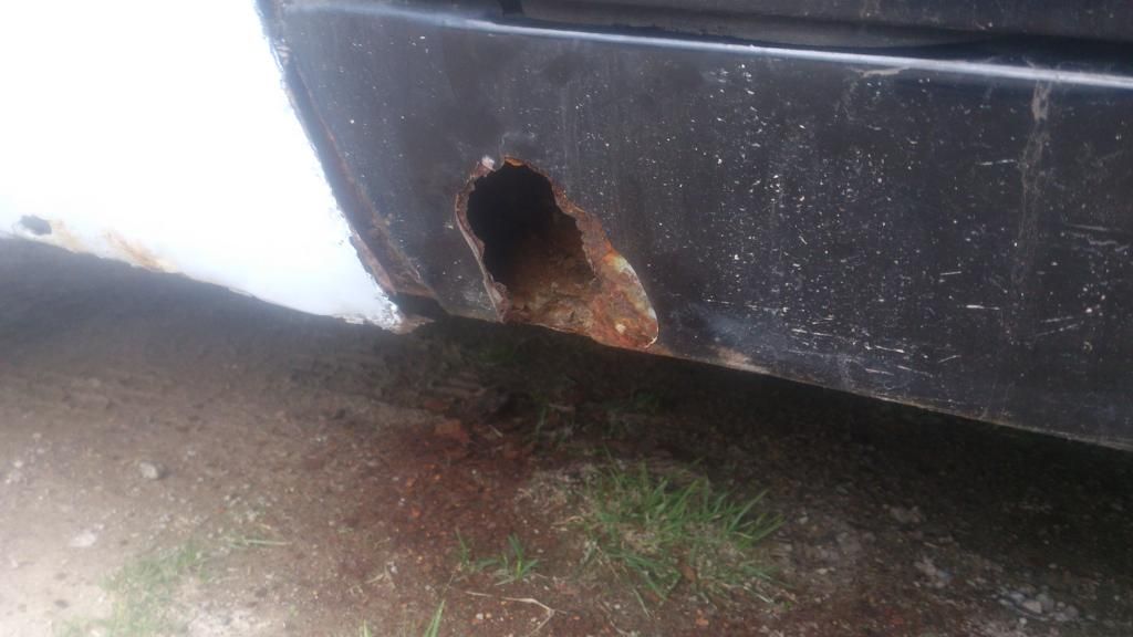

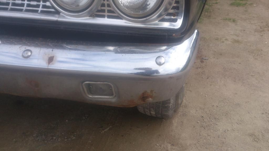

On further inspection I found a lot more structural rust than I had counted on, some dents and the center link is worn out.

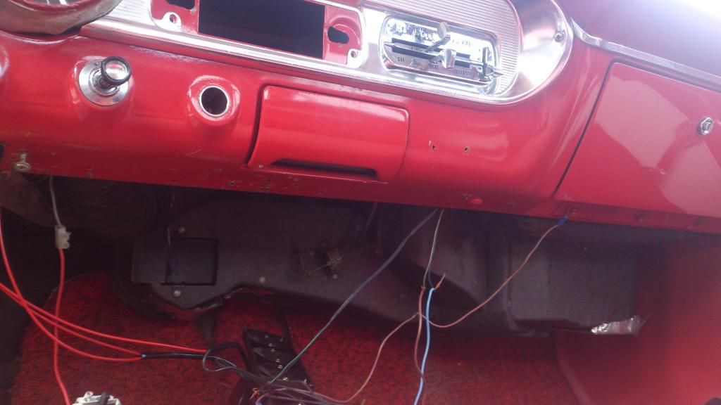

I pulled the dash apart and started rewiring it.

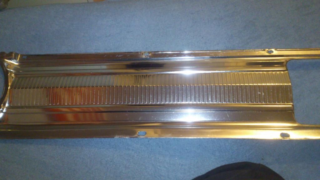

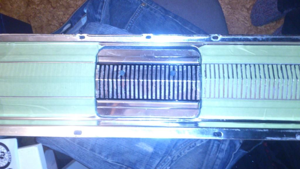

I masked the rear panel and the fuel filler door. So I could paint the stripes that were missing.
