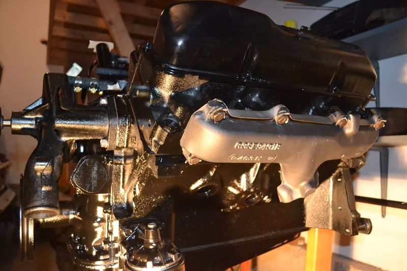

So I received my numbers-matching 390 back from the rebuilder yesterday; very exciting (very expensive)! However, I wasn't expecting the rebuilt engine to have the metal heat shields between the exhaust manifolds and block. Mac's Auto Parts says the part is "correct for 1960-1974", but I don't recall seeing any concours rebuilds with heat shields. Did Ford install them at the factory in 1964?
Any other comments on the fit and finish of the engine are happily accepted. Thanks.

As a 'retired' Ford parts man, I can say that 'by the book' these heat shields were only called for on (390) T-birds, under p/n's #C1SZ-9448-E & F, denoting r/l sides. However ....I remember selling these like craazy back in the day, to the point where even the newest parts guy behind the counter could do it from memory. lol

They came installed on the 61/ BIRD. The engine compartment was small (uni-body) and they were to lessen heat transfer.

funny lookin valve covers for a 64
Those were just for the purpose of painting her black. Does this look better? ;)
BEAUTIFUL!

Hold on. That explanation about the heat transfer sounds hinky.....
...hinky...?
What does a tiny piece of tin between the manifold and the Block have to do with HEAT in the engine compartment?
I will let you explain their purpose then...

YOU said they're for heat... :) Great, I get that.... But they're between the BLOCK and the MANIFOLD.... What exactly is being protected here? besides the head I mean?

Start with IGN WIRES and BOOTS for starters.
They deflect heat away from components.
Do you remember the heat deflectors on the Y-BLOCK?
