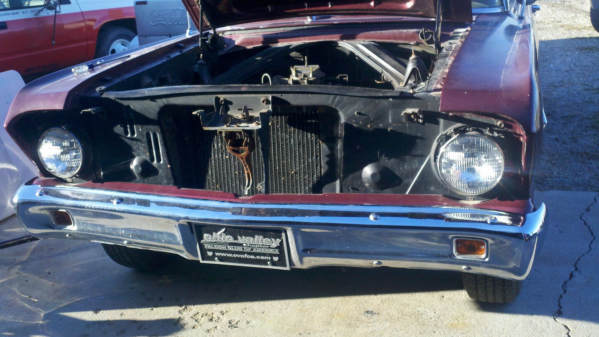

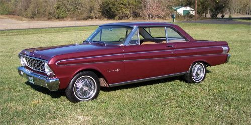

Getting my Sprint ready for the Nationals, I bought this car and it was in Arizona it's whole life, Door seals and trunk seal are hard and need replaced, and the rear window seal has a few cracks, so I will replace it as well, so I am taking it apart to have repainted same color, also installing New Stock Seat covers, door panels, carpet, I bought it at the swap meet in Dearborn in 2010, and pulling the motor, adding a better motor I had rebuilt already, and adding a new clutch while I have it apart, and last, adding a TRU Trac rear end, with the same 3:25:1 ratio, I also have a peice or two of trim with dings, that I will be replacing/fixing, while it's apart....Stay tuned, being from Arizona, I am calling this the Phoenix build....

picking it up and getting it on the stand...old shop truck!
Motor;

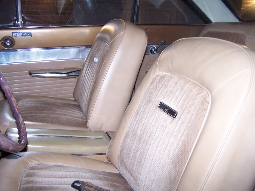

Clean wire brushed the floors, and SEM Rust Sheild painted the floors, also installed my Tachometer, now installing trim, new carpet going in, also had the new seat covers I bought at the swap meet in Dearborn streched on my seats.....MORE to come.....
