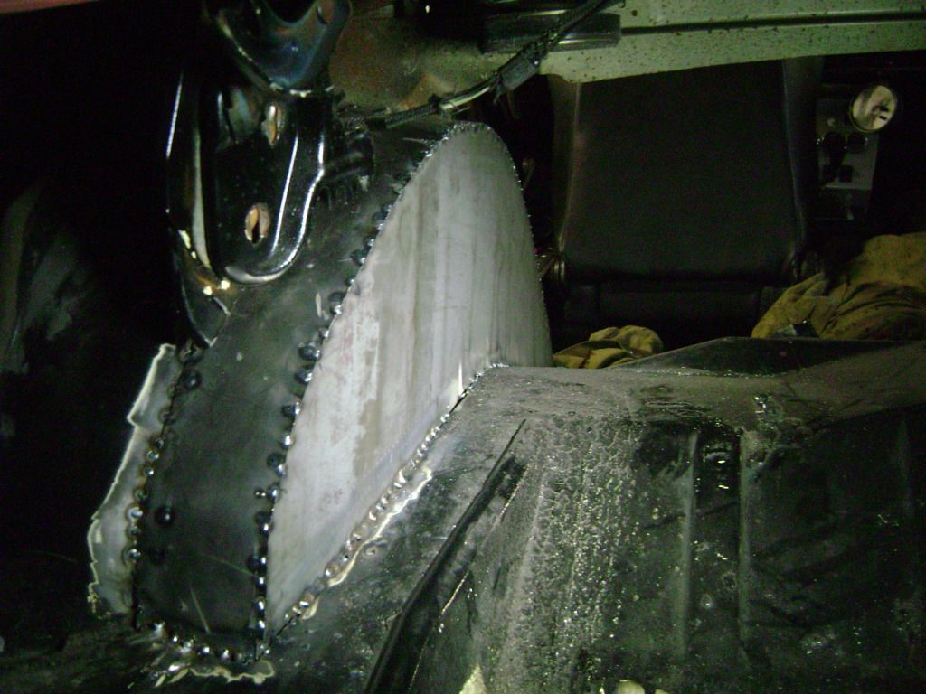

Then I quickly realized the 315's had no clearance on the inside. So out came the wheel tubs and that started the mini-tubs. Sure I could buy some, but we are a full race shop. So why? haha
