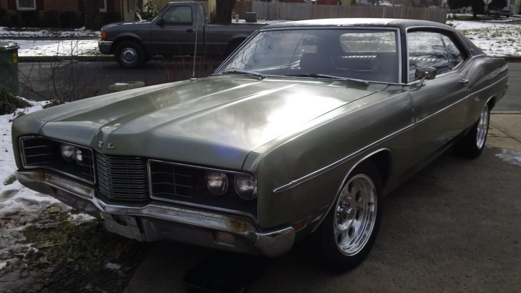

I have a 1970 XL. I am wondering if I can use the terms XL and Galaxie interchangeably. Specically, I am shopping for rear coil springs. Moog says part CC805 works, which I thought, but I thought 8307 worked but they say 8309. I was wondering if there was anyone that knows and if there is a really good sport spring for the rear available. My title and registration simply say Ford, which it's the model which has flip up headlight covers but it's not an LTD.
i like your car! looks very nice!!!

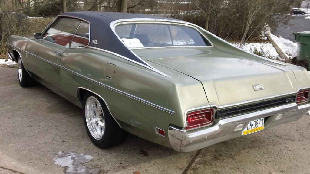

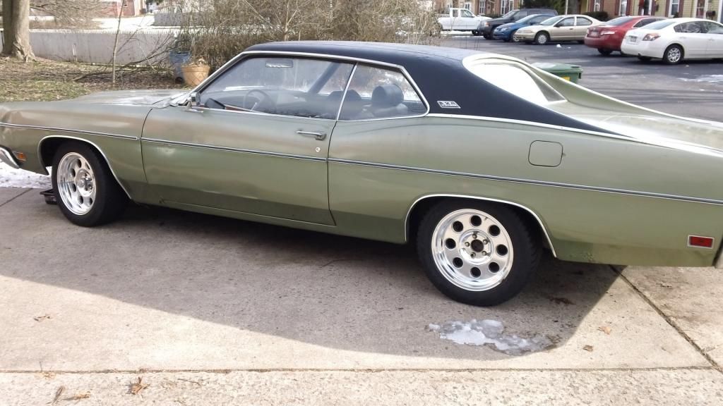

Those tires are 235/55/15 which are 27.18" on 8" rims from my Ranger in the backround. They fit both vehicals. The rims on The Ranger were on the XL when I got it and are 15x6 with a car offset and I put on the big tires 235/75/15 which are 28.88" and I had no problem with either combo on either car. The original tires were 225/75/15 and are 28.29. Those 28.88 tires are actually truck tires but looked good on the car, but "hot-rods" usually have wheels and right now that's how it has to be. Its just economics but you're right.
wow, for some reason i thought three wheels on your car were either 16 or 17"
847 Posts
:frown:
...the days of air shocks...
No more air shocks. :) Ride is smooth 30" tall tires
The tall tires really leveled it out with the tired rear springs.
Old pics, now we have matching front tires
