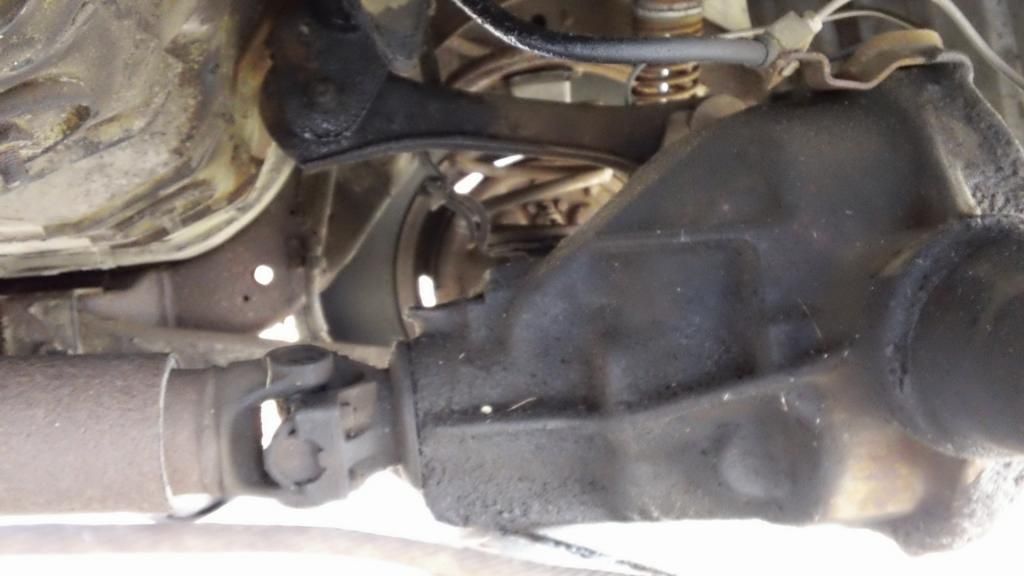

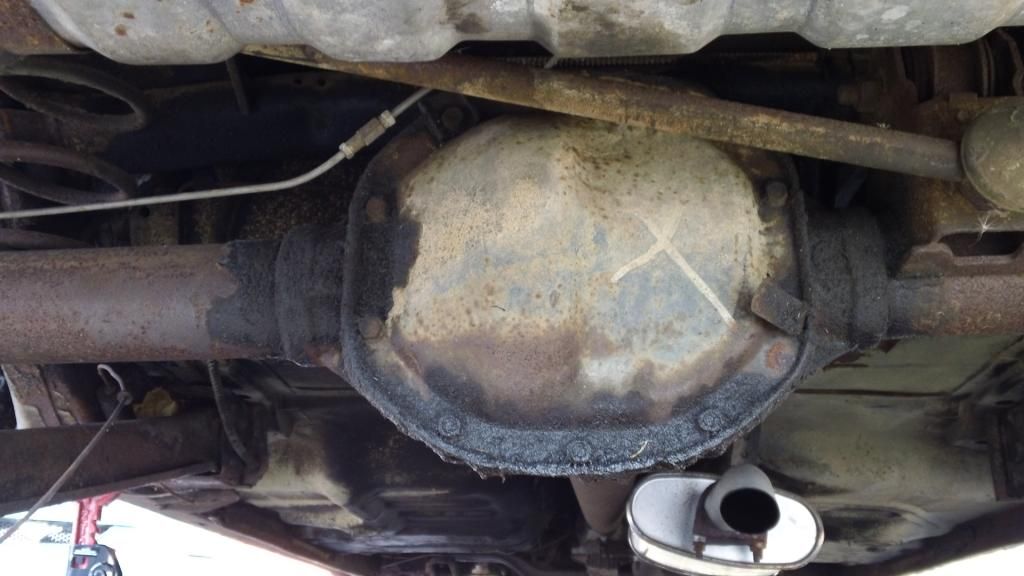

I just bought a 1970 XL. Appears the rear is an odd ball. I don't know what it is but it's not a 9 inch. So how do I go about installing better gears in the car? I'd like either around 3.50 or 3.70 or something in the vacinity. The only replacement part I found so far is a Felpro gasket. I tore off the ID tag so part is missing but I can see "75" which I assume is "2.75" which is the ratio. I will remove the rest of the tag but it is raining.

It's a WER rear end. You'd be better off getting a 9" and swapping gears.
My '70 had one of these with a 2.75 ratio, and I simply fitted a 3.25 9" from a '71 Galaxie.
