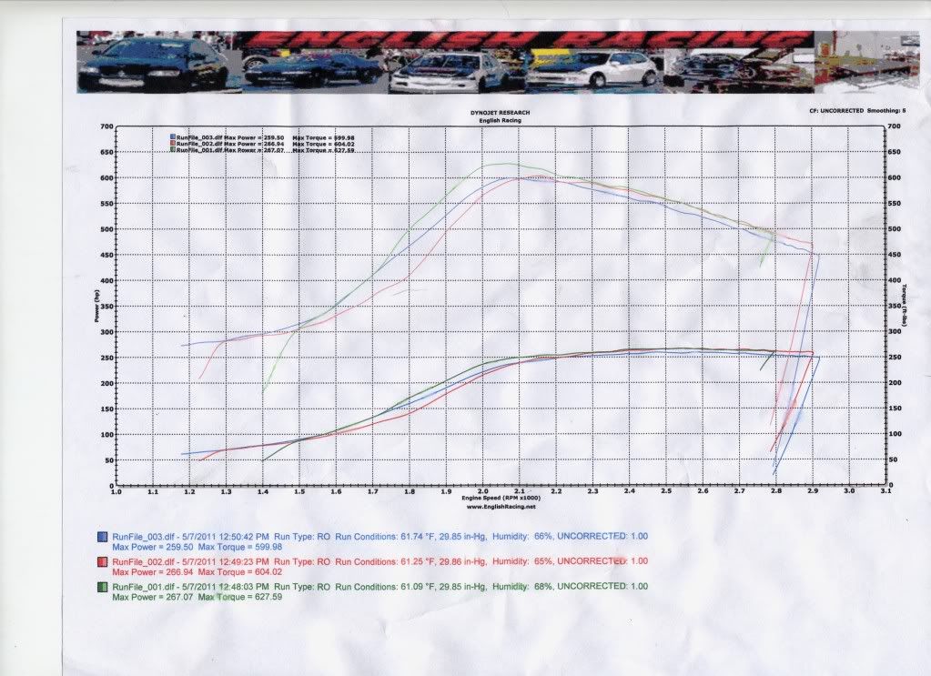

Heres my only dyno run i have run
Green is diesel red is bio blue is vegi. Stock injectors,lift pump,afc tuned homemade plate a cross between a 10 and a 100 left a little of the bump in there,4k gsk,60lb valve springs, 30lbs boost, 16.5 deg timing, 3 1/2" full exh
