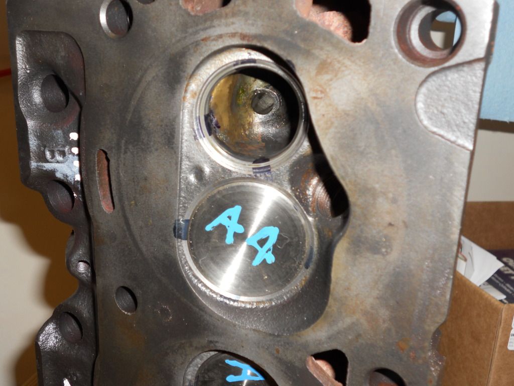

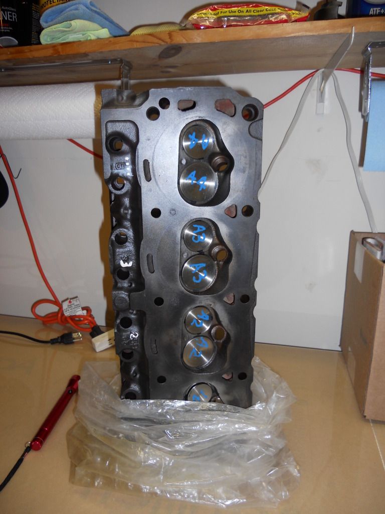

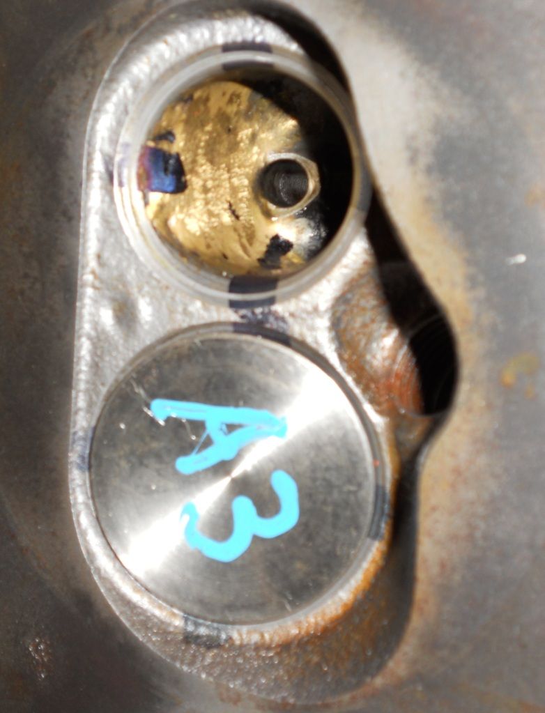

I got these 289 heads awhile back and was looking closer at both heads when I noticed some gold or yellow epoxy in all the intake bowls on one of the heads, I'm wondering if this was to fix mistakes or make the flow better. As you can see they have been ported and have other machine work done to them, I thought these would be great for a mild 280-300 hp build.
Can some of you guys enlighten me as to what that stuff is and is it safe for a daily driver. These heads were for SS class and the valves are stock size.

those are not Hi-Po heads , just worked over regular heads

According to my ford book head number C5AE is a Hi-Po head unless they printed the book wrong. I know there are no valve spring pockets but they do have the smaller 52-55cc chamber which is good.

I think they are Hi Po heads. I can make out the slotted pushrod holes in the first pic.

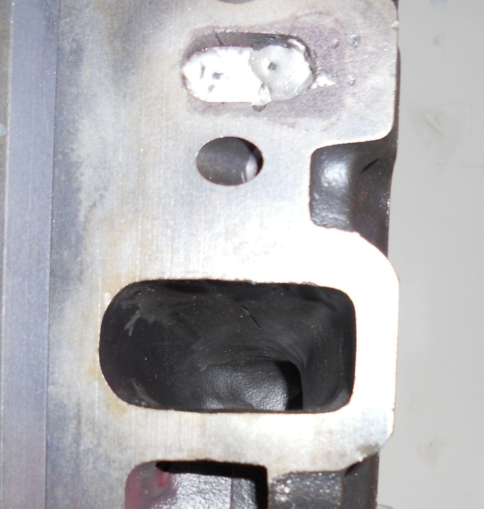

That looks like brazing in the exhaust ports...not epoxy

FE, you think they would have done a boo-boo in every pocket? I could see one or maybe two but not all of them. I'm having a shop check them out and see what they think. If your right then yeah I'll junk them fast!
