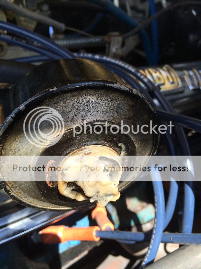

I noticed an oil pressure drop, and decided to check my oil. The dipstick measured perfect, and the oil is as clean as a whistle, however, when you take the top fill cap off of the valve cover it is a different story. Also, I notice it is blowing oil onto my intake manifold. At first I thought a head gasket, but the oil in the pan is clean. I have never seen this happen before. Anybody know what would cause this? It is a 1967 390. Take a look at the picture below. It is like this in both breathers.

its condensation causing that..
not to unusual with these cars .. we don't drive them to much..
or mostly short distances...
warms up then cool off.. especially this time of year...
air is cool and damp..
as engine cools off , it draws that damp air inside..
on daily drivers ..
engine stays hot for longer time and being driven every day...
so that moister heats up and evaporate and get sucked out thru your pcv system , then blown out the tail pipe....:wink2:

Yup, fairly common moisture coming into the crankcase.
you can try to reroute the incoming air to a dryer source or drive more and get the engine hotter.
Main thing to check on an FE with this issue is the springs on the rocker shaft. The moisture can rust the springs and they will break.

Might be possible with that much condensation to plug some of the oil return. I noticed a lot less condensation when the cars went to the heated air cleaners so the ventilation to the crankcase was also warmed. They were not as pretty a chrome open element but they did a good job with the condensation.

I started the motor today and the oil pressure gauge and tach were not working, so I think I am ok with the pressure problem. Also, I checked the dipstick today after running it and now the milk is in the oil pan, so I think I got lucky with the warning up top. Definitely a head gasket. The distributor gears were all covered also. So I am tearing the motor down now to replace these head gaskets. I am going to be so close to that one piston I think I might try popping that piston up from the bottom and replacing the ring while I have it all apart. I can post pictures of the tear down if anybody wants to see the progress.
