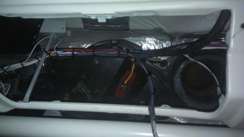

Wiring is nearly done, took much longer than I thought.
Here is a shot through where the gauge cluster will go

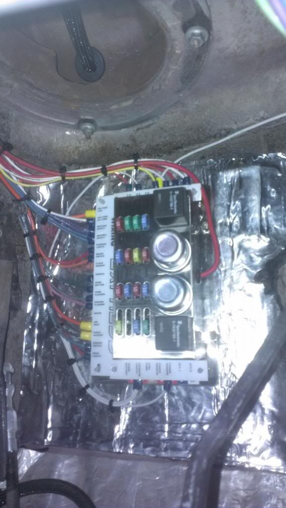

Fuse box

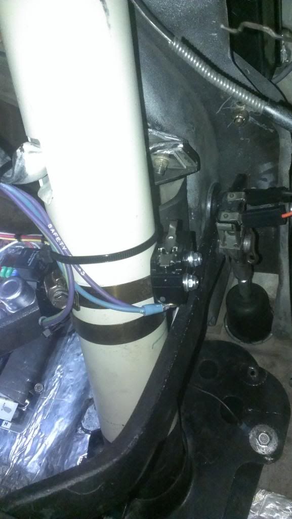

Here is one of the micro switches. This one activates the 2 step when the clutch is pushed and the 2 step switch is on, thanks to Dennis for info on these switches! Super easy to adjust, just move the band clamp.

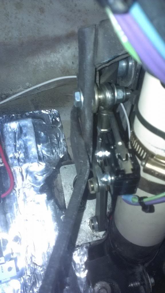

Here is the second switch, clutch safety switch.
