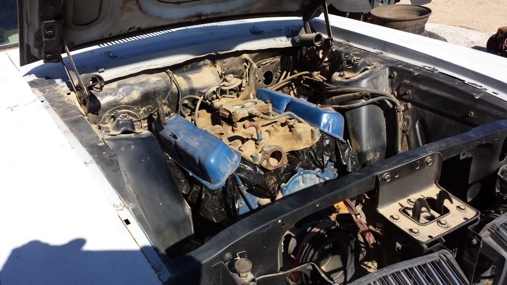

Engine compartment and the 351.
Dirty and dusty, but overall pretty well intact it seems. Excepting the obvious brake hardware of course.
