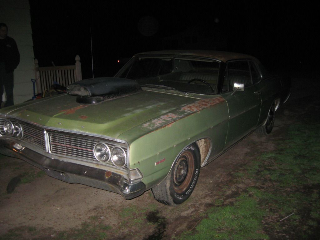

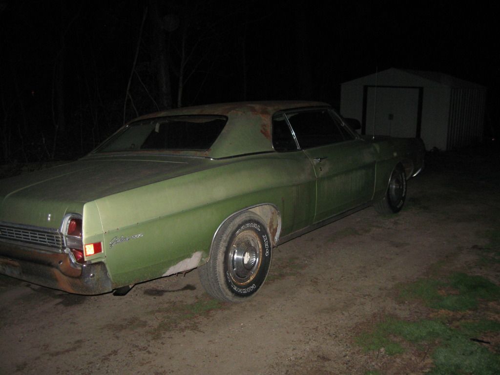

I just traded my 100% rust free 87 GMC 2wd Suburban for a 68 Galaxie 500 2 door hard top. It has a 390 with automatic. I might have just lost out on a real nice truck. I did look over the car real good before I bought it and saw the issues. Both sides under the doors have frame rot, it looks to be just the frame bottom is gone. The trunk inside looks good, quarters have just a little bit of rust, a couple small holes in the floor, and a poor interior. The good is I got to drive it home and it made it. It drives amazingly, aside from the scare that I though the belt came off.... it turned out to be that the front left hubcap came off. It looks like, according to the registration, it was last road legal was in 99.

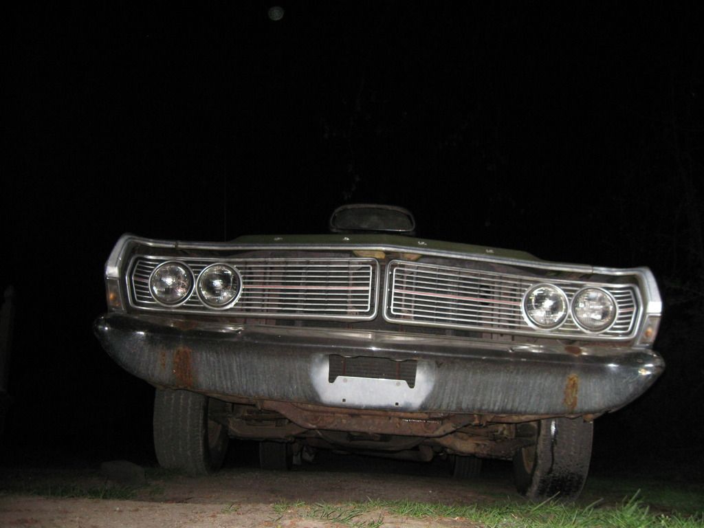

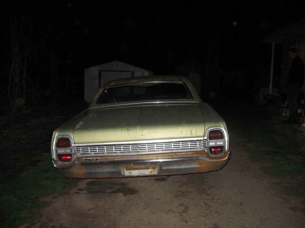

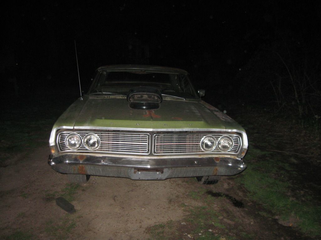

I took some better pics of the car. Also upon inspecting it more under the hood, I realize I need a set of manifolds or headers because they are cracked all over. I also realized that the roof is real thin, its about rusted threw in some spots. It looks like I've made a bad decision to trade my suburban even up for this car. I don't regret it just yet, just sux the car is worse than I thought it was.
