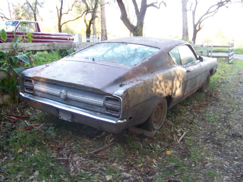

1969 fairlane 500

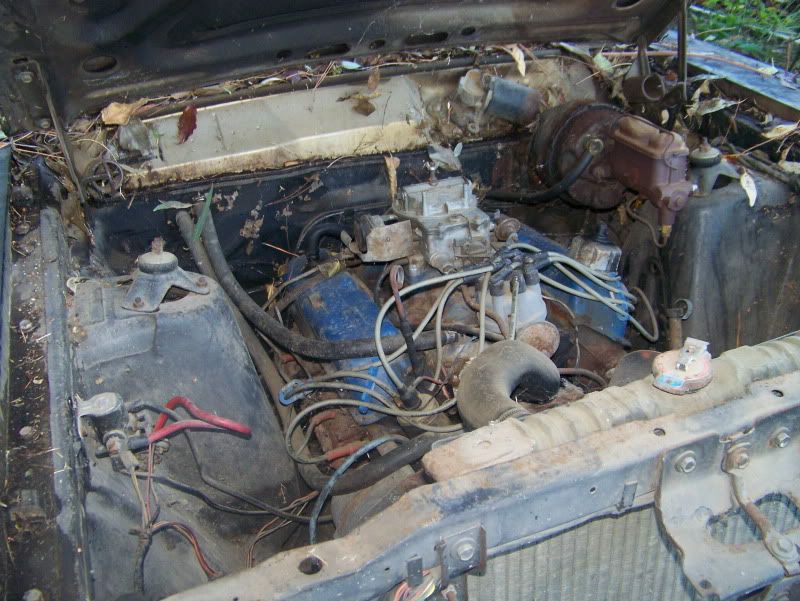

302 v8 car
c4 automatic
more than likely a 8" rear end
bucket seats
power steering
front disc brakes
power brakes

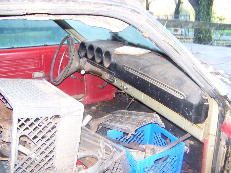

lots of extra parts inside the car

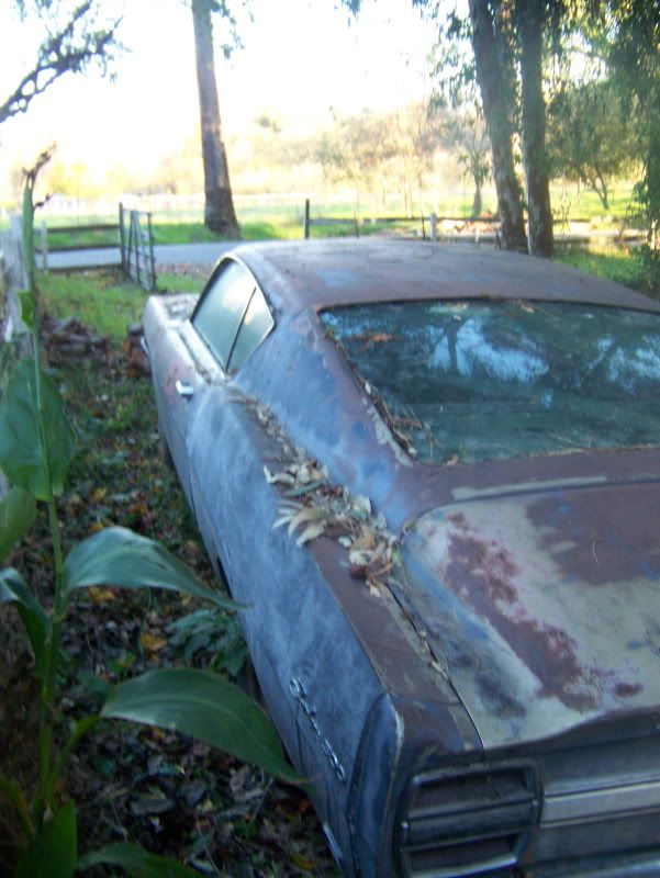

and best part of all... a RUST FREE chassis.

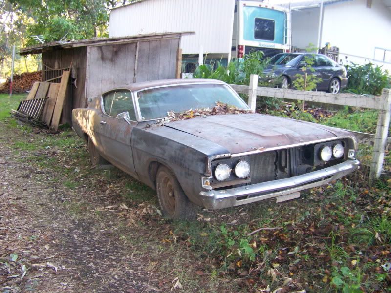

picked up this pretty little thing for a 1000$
here it is, new pics coming on thursday

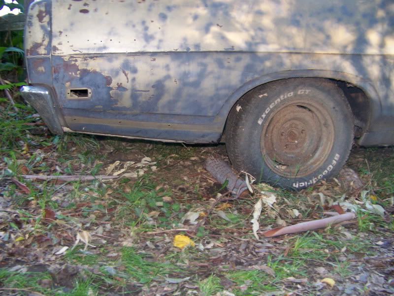

and thats not surface rust, its an old brown paint, slowly flaking off
