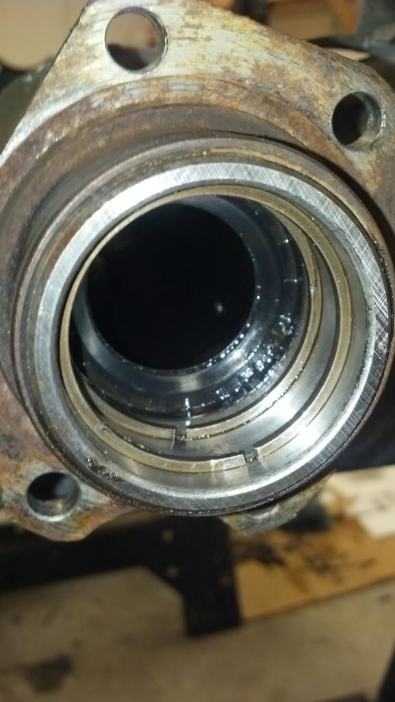

This is a 8.8 rearend I purchased from a Mustang salvage yard. I was told it was a 94-98 8.8. I am doing a 5 lug disc brake conversion on my 88 mustang. 13 inch cobras on front and 10.5 disc on back. I was told this rearend was a direct swap, just a little wider. I have changed axle bearings and seals in a 8.8 before, but this one is different. This is a picture of the end of the housing where the bearing goes. The bearing used to ride in between the 2 raised ridges you can see in the pic and had a plastic cage around the rollers. This housing also has another seal behind the bearing. I guess my question is, is this a 94-98 8.8 out of a Mustang? All the bearing kits I find are not for this housing and only come with one seal and it looks different.
Any help would be appreciated

It looks like your rear used a 2-piece bearing. Measure the OD of the seal/race that's still in there. I'll bet it matches the OD of standard 1-pece (race and rollers) replacement bearings. Assuming this isn't one of the rare floating-axle versions (no C-clip), then you should be able to pull the seal and race, and replace with a standard raced bearing and outer seal. Measure everything carefully - especially your depth.
Just for comparison, take a look at Timken's listings here. Note their replacement bearing and seal set looks much like yours, with a deep O-ringed outer seal body. Also read their notes about how it is different and the dimensions they give under the "Attributes" tab in the pop-up info. There are two different 8.8 bearings even in the same year but different models - the 6408 and the 5707. HTH

Thanks for the reply. After some research I found out that these are Axle replacement bearings. They are use when the axle is damaged. These axles have a little pitting on them but not real bad. By using this setup it moves where the bearing rides on the axle. I am just going to replace them with another set of the same kind.
Thanks
