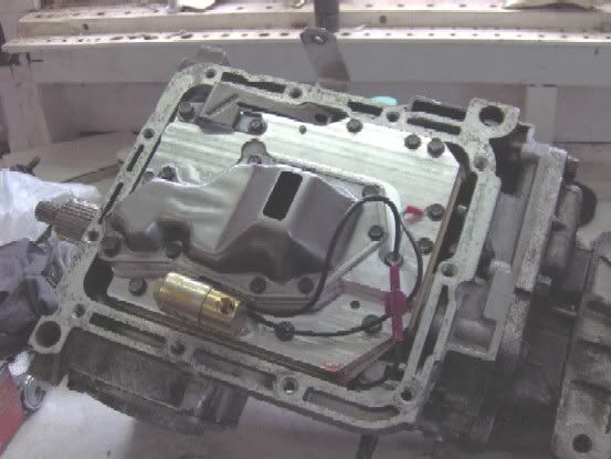

There are a couple of styles of extended pickups that Ford used. Bronco 2 comes to mind. Check the pics on www.bulkparts.com
Use the filter with the rubber grommet and make a tube .I could dig up a pic or take a pic of mine when i do it soon.

Could you send me a pic. I was going to made a filter from a mid 70's mustang with a deep pan fit.
Does a filter from a bronco fit a 60's VB. DO you know the part #
The filter i have is the same as the one above Mario posted.For the early one ???
That filter does not fit a early VB. Two hole don't line up and it doesn't cover the whole raised section. How do you get it to work.
Sorry about that but I have never used an early valve body so I do not know if it will work.
I have fabricated approx the same thing using a peice of tube epoxyed to a filter though.
On 2006-02-22 05:27, rbizz wrote:
Isn"t your PA VB a early one.
Well it is for 70 & up, early to me means 69 and before.
I have used the filter in the pic on it with no issues.
PA brake VB has a machined billet transfer plate, only the valved portion of the VB is stock. So it is machined for the 70 & up filter.
I have two PA VB and they are for the other filter.
Pic of PA VB with the extended filter on it.
