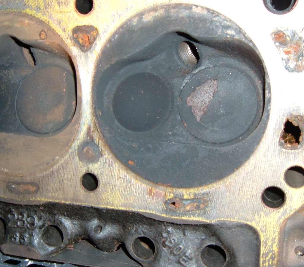

These must be California emission style heads that have the thermactor pump pipes on them. Stu
This is the pic I was talking about.....large round holes.On 2006-03-15 20:07, 67fastback wrote:
hmm, one thing I noticed about theses heads is that they have small oval shaped push rod holes.............
