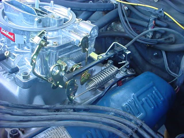

Does your 69 have a bracket like this:
http://img.photobucket.com/albums/v404/57fairlane/70ThrottleLinkage002.jpg
If so, I used a bracket I bought out of the chrome section at a local Autozone for around $20. Here it is mounted:
http://img.photobucket.com/albums/v404/57fairlane/70ThrottleLinkage004.jpg
