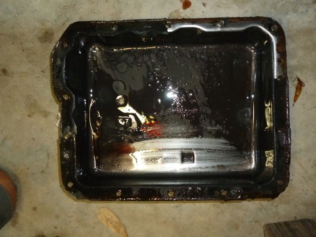

In the mornings my transmission won't even creep at idle. You have to run it up to 2,000 rpm just to get out of the driveway. After a few blocks though everything is fine. Anyone have any thoughts about why it is so sluggish when cold?
I is supposed to be a rebuilt 1959 MX Cruisomatic (pre-vacuum modulator). I *think* it has a over-2000 stall converter, based on my tests. Fluid is dark red but the bottom of the pan has a layer of black gooey stuff. I put a can of Trans-X 500 miles ago. Filter is clean though when I pulled it off an extra cup of fluid was released from up in there.
The dipstick tube goes into the [pan. The fluid level, when barely covering the end of the dipstick, is 1 1/2" from the top of the pan. When I check it cold it has risen up a lot on the dipstick, over 4". Does this seem like a lot? Sometimes I leave a puddle, I think it is coming out from the top of the tube. So maybe I am not keeping it filled right. What is the correct level?
Any thoughts, recommenations of things to do before I put the pan back on? Thanks!

Black goo is kinda 'normal' if it doesnt have a lot of sparkleys or chunks...

The dipstick indicators may not be correct because it is not the stick that goes with the transmiddion. But I checked again and I would say the level (engine hot, in idle and drive gear) I am at now is 1 1/2" from the top of the pan. and 1 1/4" from the bottom. Basically 45% full. When it cooled off the fluid goes up the tube another 4 or 4 1/2 ".
I calculate the volume that drained was 5 qts.
