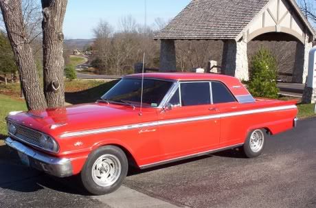

I have a 64 289 the oil pressure is lower after the engine warms up but no lifter noise I have a slight knock at idle. Doesn't use any oil and has great power. I'm thinking I have a weak main bearing. Question is
Do I have to pull the heads and pistons to change main bearings? I believe I have to if I'm changing rod bearing. It was rebuilt in the early 80's and has maybe 20,000 miles on it. Runs great and always starts right up.

I'm going to pull the motor anyway I want to fix an oil leak on the front of the motor and put a new tranny in and paint the engine compartment as well and paint the motor. as ez as it is to pull the motor thats what I'm going to do. I just want to check and change the bearings while I have the motor out of the car. I had a guy tell me that you can't pull the crankshaft out without pulling the heads and pulling the pistons. I thought I could pull the crank and check the crank bearings and the rod bearings without tearing down the whole motor. I did not want to pull the heads and lifters as they are in great shape. As for the knock it sounds like it is in the lower part of the motor but can't pin point it. When I turn the AC on you can hear it more but it draws the motor idle down. It sounds like a sewing machine at idle. it's hard to tell where it is coming from I have had guys look at it and they just say if it runs good and has been doing it for so long just keep running it. So i don't think it is something that is going to gernada the motor I joust thought I would check into it while I had the motor out of the car.
