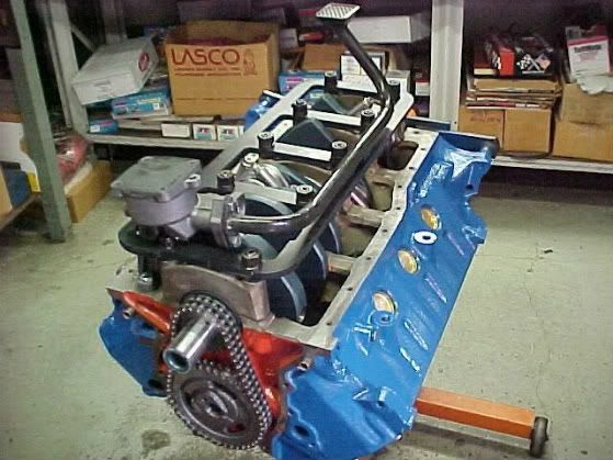

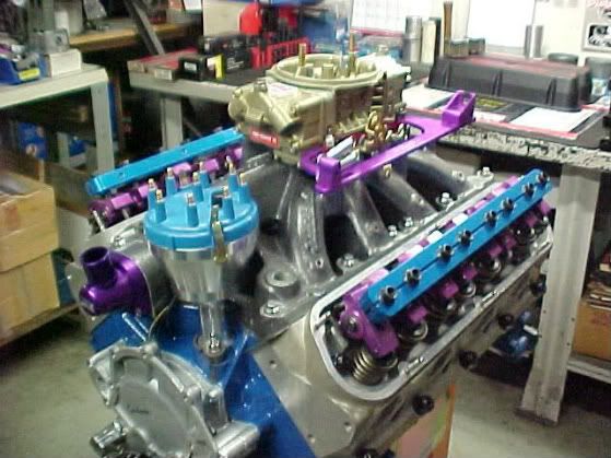

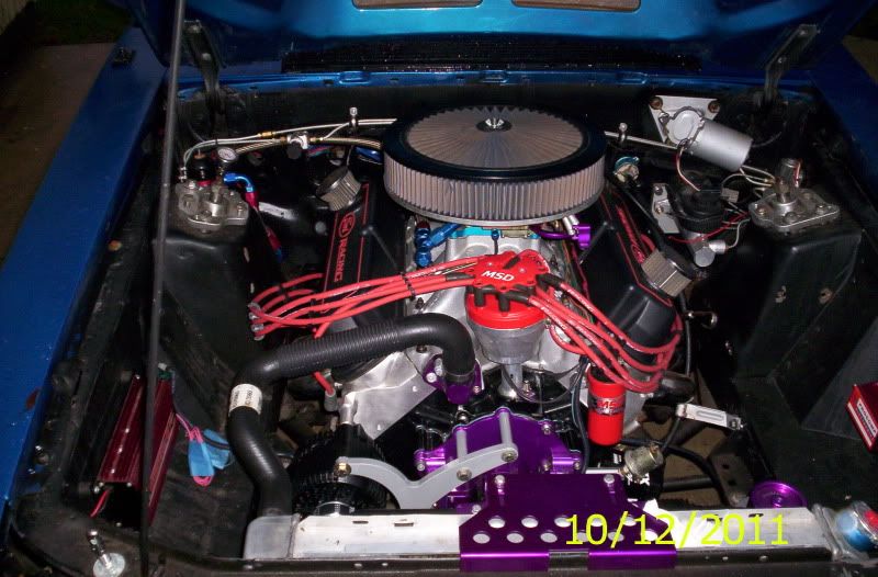

Thought I would post my 427 Windsor I did a build on a few yrs. ago. Motor has the following:
  1. Block = 1974 Stock Block
  2. Short block = Ford Performance Solutions Eliminator Short Block
  3. Compression = 10.7 to 1
  4. Heads = Avenger 205 with Up-Grades 2.08 valves
  5. Rockers Arm Ratio = 1.7
  6. Camshaft = Solid Roller with .683/.685 lift, Dur. 252/257, Lobe Sep. 112*, 4* Retard
  7. Intake = Super Victor
  8. Ignition = Pro Comp 9000 Dist.
  9. Carburator = Pro Systems 950 (840 cfm)
  10. Headers = 1 3/4" Basic Dyno headers
  11. Balance = 28*
