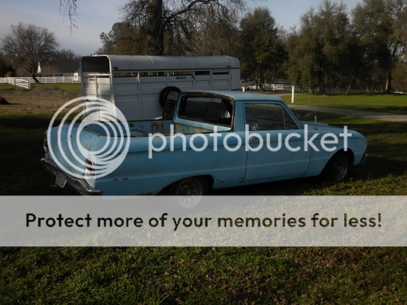

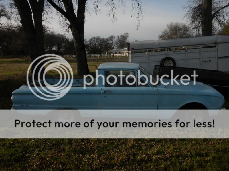

Just got myself my first old car, 1963 Ranchero. I'm an old motorcycle guy, Triumphs specifically, having wanted something with a few more cool points than my 97 s-10 to haul bikes around with and be my daily driver. Have a few little things to sort out before the s-10 will be fully replaced, but I'm learning what I need to. Manual is on its way to my mailbox, so I can learn what i need to. Got a set of 175/80r13s off ebay to replace the cracked and rotting 170/70r13s on it. Getting a rear windshield cut locally next week (after this little snowstorm - first this winter!- is over), and need to go through the carb and reattach the manual choke.
1968 or 69 200ci Straight 6
3 speed on the floor
Missing left side headlight cowl, hood "scoop" trim, and various other bits.
The good is it runs, shifts, and (after a simple brake bleed, first ever for me) stops. Pulls hard to the left when braking, accelerates crisply, and rattles like a mother without any door seals or headliner. Seat vinyl is pretty solid, dash is intact, and floors are not the worst I've seen. Tips and suggestions welcome, like I said I'm new to cars, but have pretty good knowledge of old Triumph motorcycles (do all my own rebuild work short of machining). I'm looking to simply keep her running, maybe freshen it up with simple mods, and enjoy life on the road without the hassle of smog certs ever again.
