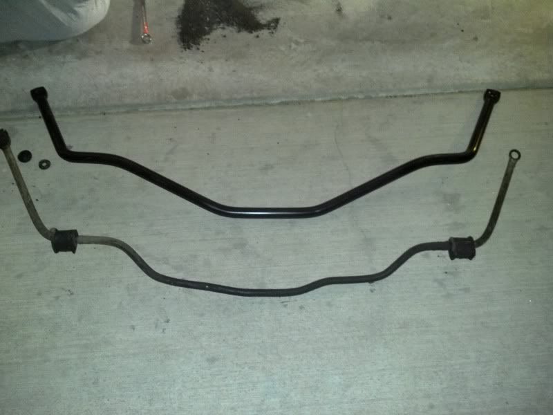

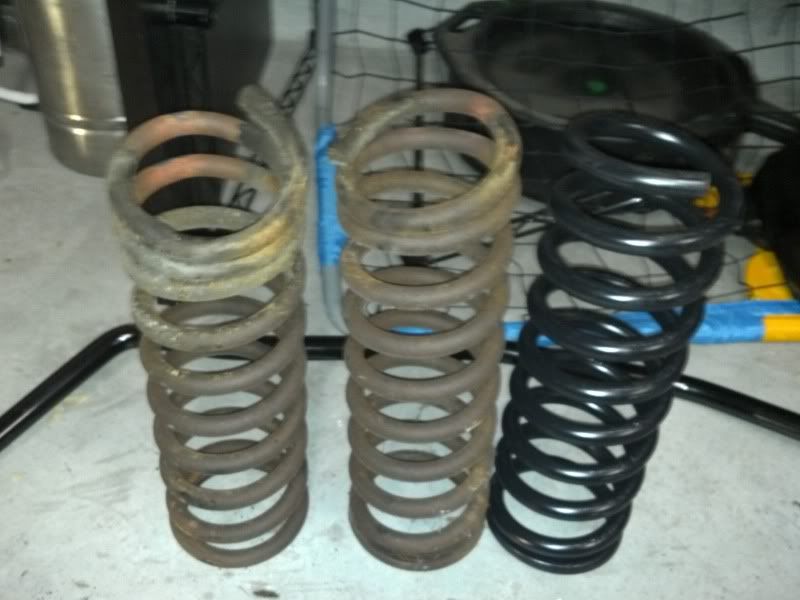

after a long weekend of replacing ball joints, springs, bushings, etc.. the 66 feels like a totally diferent ride... i know some people say the 1 1/8" sway bar might be too "tight"... but i dig it!!
Old heated springs vs a new spring
Old sway bar with new sway bar (if anyone in Socal wants the factory sway bar let me know)

a 1.125" front sway bar for a 66 with a big block is ideal and not too stiff. i put an 1.25" in my 460 powered 66. back around 1995 i also put an 11/16" rear bar out back i got off a cougar xr7 with coil springs in the rear. i put the bar as far back under the rear trailing arms as i could for maxium effectivness. i dont remember the coil spring rate but they were custom wound to my specs at the time and i argured back and forth with the guy at eaton springs until they finally agreed to make them. they said they would be too stiff, but they were perfect. i had to get cutom valved shocks to control the rebound damping. oh look , this is post "666" for me ! WWWHHHOOOOOOOOOOOOOOOO !!!

Low, let's see pics of how she sits and the numbers on those springs.

A front sway bar can be too big or too small in a general sense, but the more important factor is how it is balanced with the rear bar. Tracking on rails in the front with a marshmallow in the back 'feels' better, but is actually a slower (and potentially dangerous) way to get around a corner. Quick and fast is all about balance and chassis tuning.
