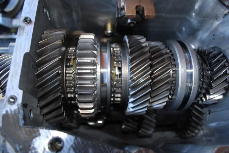

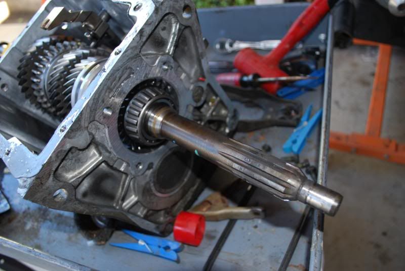

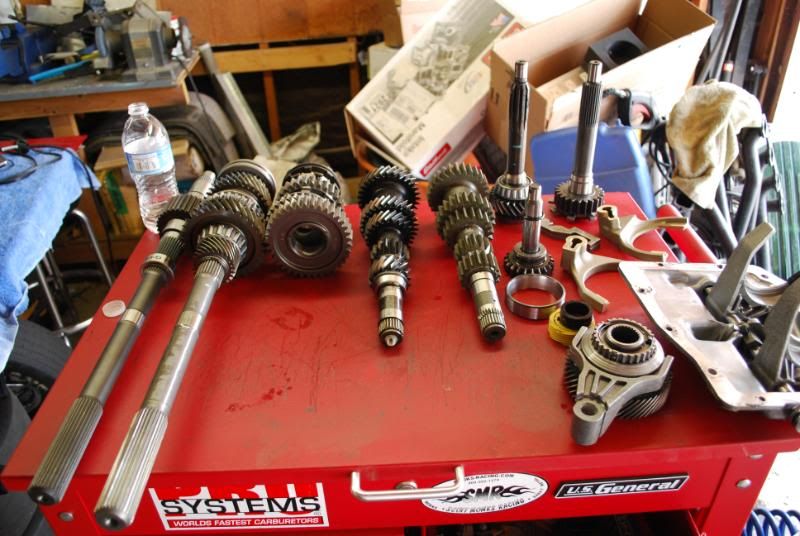

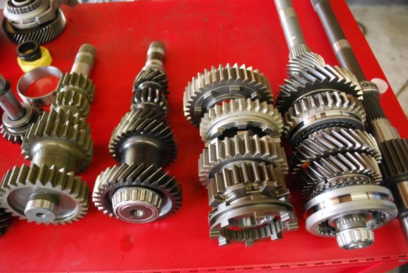

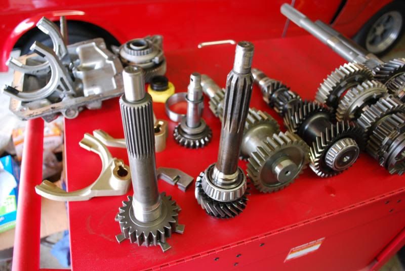

In my quest to be a real stick shift drag racer like Dennis, I've finally gotten around to swapping in my G-Force faceplated gear set.
Here are some pictures of tearing down the T5z and some of the new gears and stuff next to the old. Hope to have it back together by the end of next week.

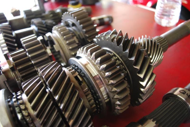

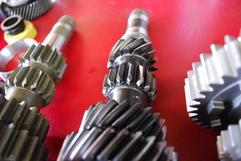

Here are some pictures of the old T5z stuff that usually shows wear. You can see the 1-2 reverse slider has some rounding on the teeth. 3-4 synchronizer assembly shows some very minor wear with very little rounding.
The teeth on second gear that mate up with the 1-2 slider are rounded and have wear. The same teeth on third gear have less wear but are still rounded a bit.
Everything else looks great. Teeth on the gears show no funny wear marks and don't have any pitting. I feel the transmission held up very well to how I've used it. :burnout

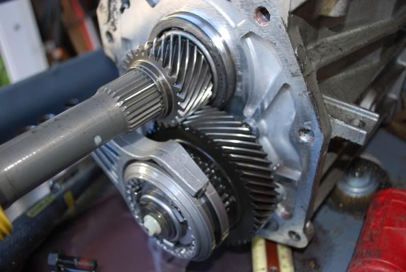

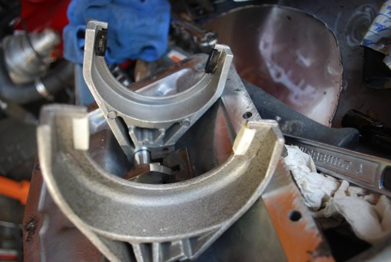

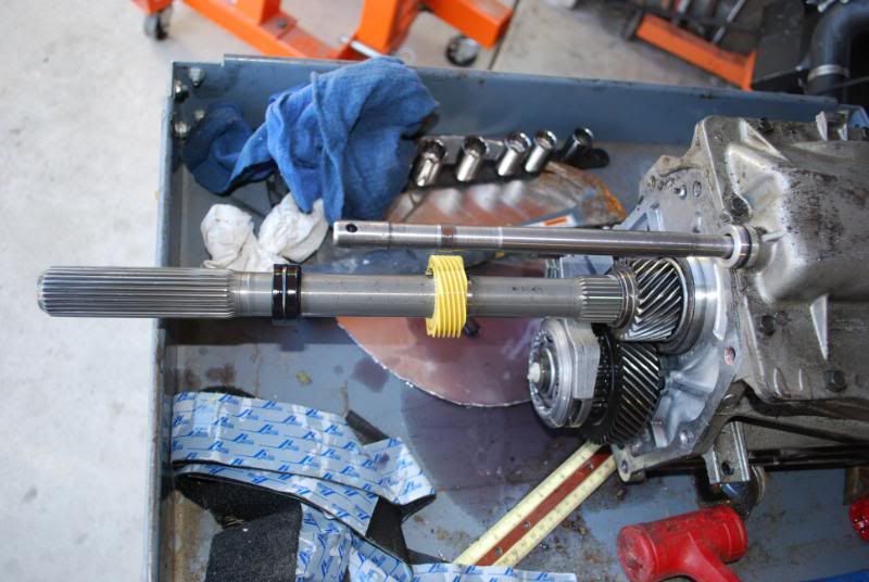

Made a little progress today. Ran into some problems otherwise I think I'd have it finished. Need to have a spacer milled down and can't find one clip. Will have a spacer milled down and I'm sure I can find the clip at OSH. Here are some pictures.
1,892 Posts
Discussion Starter · #13 ·
It's the spacer for the cluster gear. Smallest spacer leaves too much clearance (.003") and the next size up is too thick and binds up too much. They are stainless steel so you can't just knock it down to size with some sand paper. Will take a trip down to my machinist today. Places like Hanlon Motorsports sell them in custom sizes as well.
1,892 Posts
Discussion Starter · #14 ·
Finished it up. Found a used spacer at a transmission shop that was exactly what I needed. The Bob Hanlon video makes this darn simple compared to what I expected.
