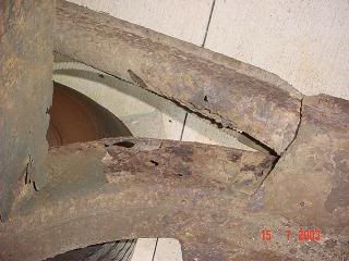

As you can see, this car was toast. Had it not been a gift, from someone that it really meant a lot to, I would have scrapped it long ago...as it was though, I felt obligated to at least do my best to try to save it. Calling around, found a frame in Arizona, but cost of transporting was very high, with no guarantees it wasnt rotting from the inside out(as they just about all did), so decided to make new sections as needed...my boss is also a good friend of mine, and let me to use the plasma/welding equipment at work after hours to put the heavy stuff together- thank goodness, as I had no idea how much work was going to be put into this thing- and what a mess it makes...150 bucks for some sheet/tubing from contractors steel, and that was the end of my free time this summer- rear rails and torque boxes fabbed from 3/16 plate, side rails from 2x4x1/4 tubing(yeah- a bit heavy) new control arms picked up when on vacation in Colorado to replace the holey ones, a few weeks later, it was finally a roller again. Part of original frame from torque box forward, and rear crossmember were all that was solid(plasma cut front little by little until full thickness metal was found).New front torque boxes have one piece bottom that extends from rear of spring hole to end of transmission mount extension, also plated outer frame, but didnt fully weld perimeter for fear of causing cracks in corners- instead cut several round holes, and welded around inside of holes- filled with seam sealer, and seam sealed perimeter to keep moisture out. POR-15 painted everything inside and out, repainted inside torque boxes after welding before top went on, so only thing not coated is welds around top/inside- hope to spray up in later. Heres some pics of the frame:

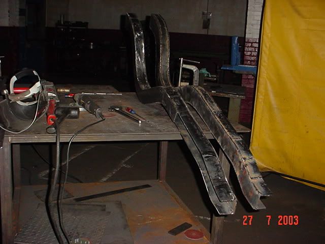

One fairly large, half dozen small patches to floorpans are all done, now looking at cutting out outer trunk/inner wheelhouse portions- hoping to be able to carefully remove a foot or so from the original lower quarters which have now disintegrated and clogged everything with rust. Poor "repair" still causing trouble- suprisingly the new/outer quarter patch panels have no rust (dug out 2" of dirt/rust, found only very light surface rust, no pitting even?). If the rust can be removed, the inner sheetmetal should be easy to fix and seal correctly, If not, bodywork nightmare- cut patch panel, cut quarter, replace panel with same patch panel(full quarters not available)...would be one warped up panel to straighten out...Will try to update when time permits

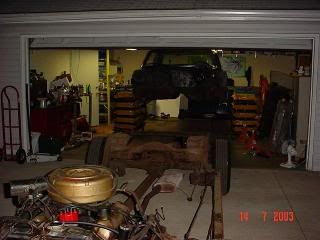

Got the detailed engine/transmission back in the chassis tonight(just a little old 289-2V with Cruise-O-Matic). When pulling the fuel pump for detailing, reached in and found the timing chain was worn out, oil pan was pitted at the back, so it got a fresh chain and a chrome Summit Racing pan. The heat riser was a bit rusty at the bottom, just trimmed it a bit- dont show, shouldn't affect operation much. As days are getting shorter/colder, indoor detailing is coming together- but hopefully will get a few more nice days to work on welding up the wheelhouses...I'm afraid of welding in the garage as too much stuff for sparks to find...only takes 15 minutes to roll out, lift body, roll frame clear, put on stands- have done it at least 20 times so far. Only 'inside' work left is detailing core support/heater plenum/driveshaft, installing parking brake cables(have to put mounting holes in frame still), and installing stainless brake lines(still waiting on AutoKrafters- showed shipped the 16th...) Starting to see the light at the end of the tunnel, but probably another 40-50 hrs work(15 or so of these outside) before the big parts can start getting put back on(doors,interior, etc...)
10/13/2003:
Well its been almost three months in the making, but tonight THE CHASSIS IS 100%FINISHED. Only worked on it a few hours this past week, as busy at work, school conferences, things around the house...but anyway, it's done. Parking brake cable locations are a bit non-standard, as I made the rear torque boxes more 'one piece' than Ford did- the parking brake cables had to exit inside the control arm rather than beside it. Panhard rod mount, tailpipe hanger, other small stuff went pretty quick, but it all takes time. As its getting dark soon after work, picked up a 500watt floodlight- for some reason my welding helmet wont always darken if its too dark outside- with the floodlight on, it worked fine tonight. Next its getting the wheelhouses/trunk finished- lots of slow going, but as its all thats left of the 'dirty work'. That milestone is on the horizon. Cant wait to start bolting the big stuff back on- right now I've got fenders,doors,seats, etc, stored in my brothers, and brother in law's garages- I'm sure theyre getting tired of looking at them, and I'm wanting to get everything back on soon, before anything gets scratched. Unless you've stripped a car this far, I dont think anyone would realize how hard it is to remove, haul, and store all the sheetmetal and trim without scratching something (and how much space it takes).

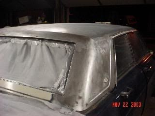

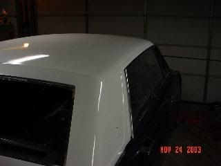

Well enough whining about a broken window...Saturday/Sunday was record high temps, figured if painting, it's now or never(next year at least), so went ahead and sanded roof down to bare metal, fixed a few pitted areas around trim studs, straightened old factory seams that were starting to show, filled dent where something had fallen on the car many years ago(was the only ding anywhere on the car- I'm still looking for the thin band of trim that follows roofline around if anyone knows a source...).
As weather was due to get 'normal' today, had to get paint finished this weekend- was still mid 60's this morning, by noon it was under 30- so I finished up about 2am last night/this morning. Shot it with 'k-36' PPG three part primer, and regular delstar enamel. That k-36 is great stuff- I used it on my first attempt of a paintjob: my camaro in '95- had surface rust in various areas- and although it's not seen salt since, no rust/ blisters/ peeling (yet)- and the car sits outside year round...must say that I liked the 'concept 2000' basecoat/clearcoat much more than the enamel- for a beginner like me, its much easier and faster to fix mistakes. The Galaxies roof got 3 flies, 2 mosquitoes, and a moth in it last night...bugs must like the enamel smell...anyway with the enamel, will need to wait a month or so before wetsanding/polishing out...on the camaro I ran the paint, was able to block/re-clear after just a couple hours...

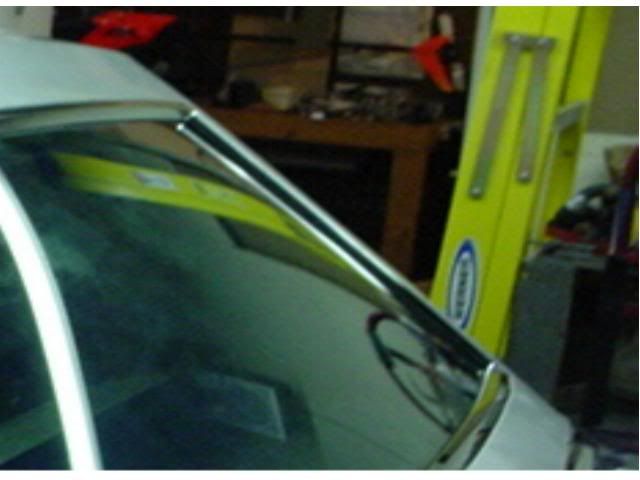

Well, good news- got a rear glass, bad news- it dont fit very well. The 'new' old glass has about 1/4" or more curvature than my roof. After all the waiting/worrying, aint about to try to send it back- maybe the donor car was tweaked for enough years that the glass took a set, maybe mine is...dont really know any way to check- anybody wanna cut me a 'template' to compare it to? : )
Packed extra sealer at the high point in the middle, will try shooting urethane adhesive around tomorrow,(hopefully will lock everything in place and give some support) and see how long it lasts...looks like trim MIGHT fit, but gonna be snug at center, and near 1/8" gap from glass at top corners. At this point...
12/19/2003:
Well, 'sprung' the trim so it wouldnt press too hard at high point in center, sprung it closed at corners as much as I could- looks OK I guess, but as you can see above, theres still quite a gap at top/bottom corners, couldnt do much there as side trim is short/straight, not really enough room to twist both ends down from center. Hopefully all the interior will be back in this weekend- then back to fenderwells/front bumper/painting inside trunk...doubtful to have done for Christmas as too much other stuff to do for the holidays, but not much left to do now...

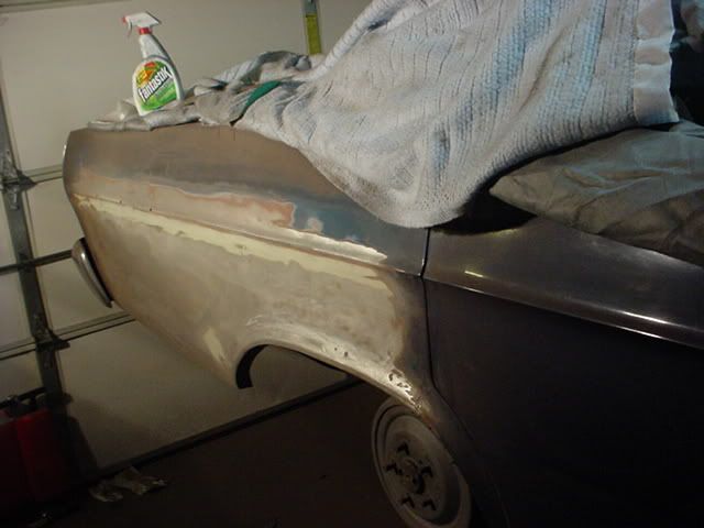

well, wasnt gonna get into paint, but just couldnt stand to look at it anymore:

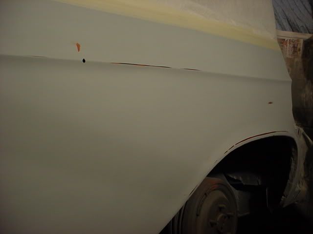

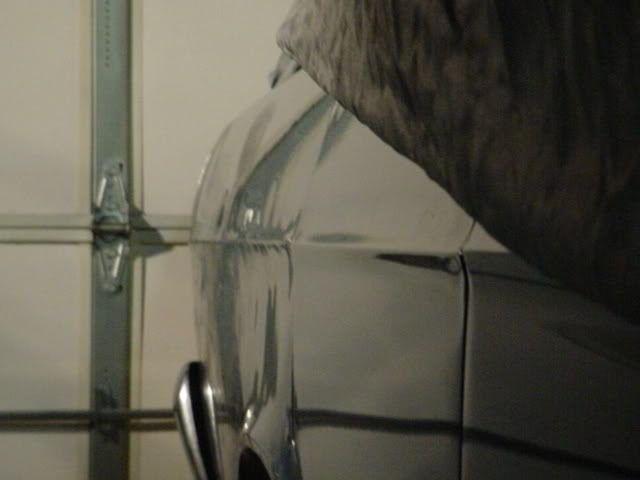

no going back now...as you could see in the pic, the weld seam is a wavy mess(look how straight that old door is!). In other pic, can see why- filler wasnt feathered more than an inch or so from the seam, with no filler at all above seam...distortion from brazing had warped top as bad as actual seam.
Ground it all out, figured no matter what its gotta look better than it did- got it rough shaped already, seams looking good, but finding other areas had waves too- just didnt notice much from the severely wavy crease. Probably will be sanding/filling for another week. put a coat on, sand almost all of it off, repeat until it all cleans up just as dark areas begin to show metals close to surface...arms already tired, but figure good practice anyway. should be blocking primer by midweek, hopefuly have paint on it next weekend- if it looks ok, might start other side too- will see if I have any ambition left. Oh well, at least there is no rust.
Already went thru doors, dug out all the nooks and crannys, etched, por-15'd. Still need one more quarter ornament, that should be last part- oops: gotta replace thermostat housing- think it may be cracked/porous, as it started leaking after a few days driving. leaked last year, thought just a gasket, but it was pitted pretty bad inside.

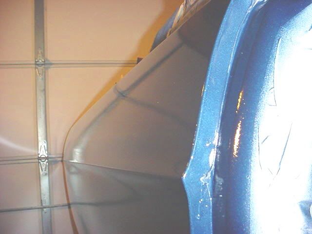

Well blocking almost finished- for the radius to trimline, found a piece of leftover basebord molding from the house was almost perfect match to factory curve(at door), sanded it a bit for tight fit, used this as block to straighten top/bottom of trimline.
Used several coats of filler, almost all of which was sanded back off...edge feathered about3" in filler, dissapearing into K36 primer/filler. The seam is about as good as I can get it, no idea how its gonna look painted, but 'when wet' looks a lot better than it was already. Not happy with dogleg blend, as it definitely falls away from the seam, hopefully the contour/radius will hide this it a little in the reflection, but without major surgery(new dogleg) or an 1/8" of bondo, it will have to stay that way. Hopefully it wont be too ugly, but still has to be better than before(never really noticed this area before, but with the 'corrugated' seam, was hard to see much else).

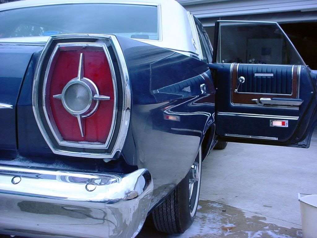

well, its just basecoat(deltron), but even with a low gloss I think its gonna be fairly straight. the dogleg area I was worried about was fine- except I missed a low spot above it- gonna have a ding showing. also got a line about 3" below trimline, a foot long where edge of block cut in a bit- oops...hopefully will have cleared tomorrow, I'll probably block after a couple coats, finish coat Sunday...

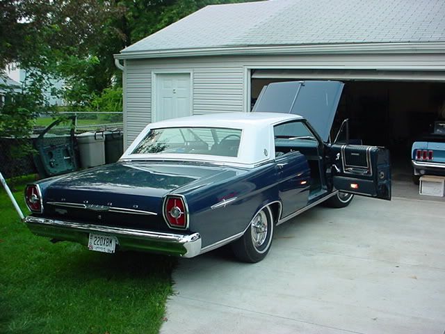

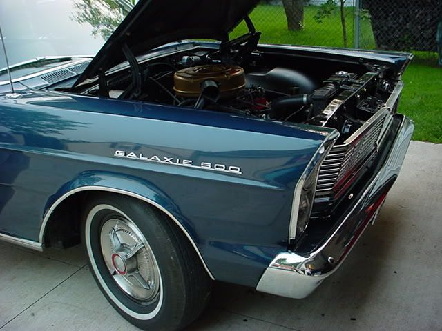

Hadnt added anything in a while, thought I'd add another pic...Ben went with me, the boys and a nephew to a local cruise spot- was gonna get a pic of him and my nephew Jeremy and the old car, but as I snapped it, he grabbed Jer's ears...'daggone kids, ya can dress em up but cant take them anywhere'...
Not much has changed on the old Ford, did find the elusive passenger side mirror(Ben insisted he 'drove that car almost 40 years and didnt need one'), I was really uncomfortable backing in anywhere without one - sucks as the NOS mirror cost 200 bucks(more than my first 2 cars did!). Also found a NOS realistic fm converter for the old am radio- not stereo of course, but gets all the stations. Did find a set of rustfree doors in michigan, as shipping is horrible from out west, went ahead and drove up to buy them while I had the chance. will strip them later, but at least I have them now- they supposedly came off a school autoshop car, no rust at all, fairly straight but all the bolts look like theyve been in and out 100 times...and at least several coats of paint...will probably sit on them for a couple years, until the car gets a repaint- up close it really needs paint but from even 5 feet away it looks too good to mess with.
Kinda looking for a set of the deepdished/exposed lug/16x7 crown vic wheels that were used from 93-96 on cars with the handling package- tried various wheels on it, and the 'sporty' wheels are just out of character with the car- I think the more formal spoke wheels would be a great match, and would really dress it up a lot.(I just hate hubcaps...cant help it...)
Ben saw me trying different wheels on it, and gave me that 'youre out of your mind' look, but he did say he liked the look of my old oem spoked mark vii wheels on it( but I didnt like the offset). I know the C'Vic wheels will look just right- then gotta decide blackwall/whitewall/RWL for the tires..
4/6/2004:
4/8/2004:

Well, sunday we took the car back to Ben- but he refused to take it...said we put too much work in it, he just wanted it to go to someone that would take care of it...was funny as my 5yr old got kinda mad at him for not taking it. Had a big red bow on the bumper, had been lookig forward to this for a long time- pulling it into his driveway was the 'finish line' to a long project...now I gotta figure how to get the mustang back inside- I guess its gonna have a partner in the garage from now on...
Monday evening the gal was in the yard, I was doing a little work on Ben's other car, my 5 yr old started argueing with him about the Galaxie again- Ben told him that it used to be his car but he wanted "mommy and daddy to keep it, so they can take you and your brothers for rides"- Bobby ran in the house to 'explain' to mom, and right away his six yr old brother yelled out the back door"Daddy its gonna rain, you better put OUR car back in that garage!"...Ben thought that was hilarious...
Ben's daughter took this pic the day we took the Ford back...Ben pulled the bow off and stuck it on my wife...
