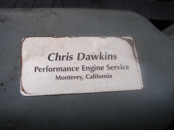

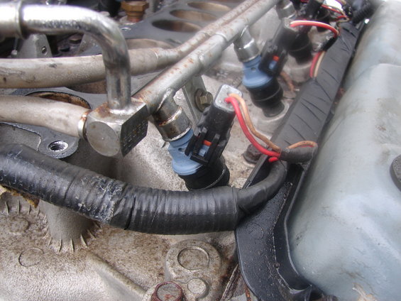

Last week I see a 94 Ford wheel chair van at PIP the motor looks pretty clean and you can tell it has been worked on I also noticed it had 24 lb injectors instead of 19lb like it came with. then I notice it has a decal on the valve cover that said Dawkins Performance Services. Well I know Chris Dawkins pretty well so I wanted to talk to him about what had been repaired on the motor before I bought it, but I had lost his number.
I do not really need a motor right now so I kinda forgot about it. I saw the van again this week so I did a little research and found his number on the net and called him yesterday morning, he returned my call in the afternoon. I asked him if he remembered working on a ford wheelchair van. He said yes he knew the van well and asked why I wanted to know.
I told him I had keeping an eye out for a late 351 to swap into the PYL and saw the van in the yard at Pick N Pull. He could not believe the van was there. He had built the motor about 5 years ago for a good friend of his. His friend had passed away about 3 years ago.
He told me the motor was a "little" more than a 5.8 it was in fact a 408 stroker motor that had been balanced/blueprinted it has ported heads and intake, He said it was a toque monster, He is going to try to find the build sheet when he get time He is developing a exhaust system for 427 cobras.

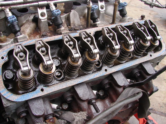

Here was first clues this 5.8 may be special
Not what you would expect under the valve cover of a wheel chair van

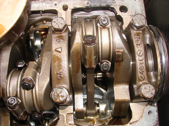

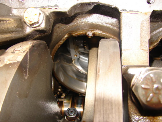

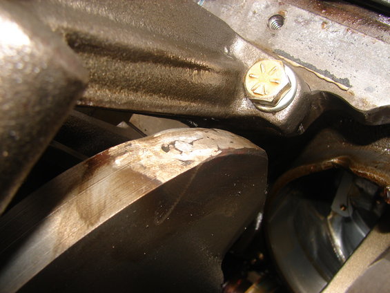

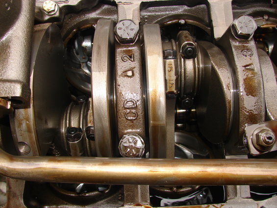

you can see the clearance work done for the stroking
evidence of the balancing

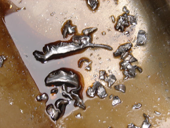

some shrapnel in front sump looks like a slinger went through timing chain what ever it was it went the timing because I found a indentations from the gears
