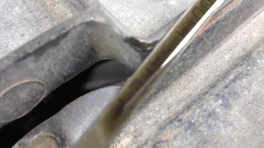

Was checking the oil today on a car I recently acquired. Noticed possible water droplets along the length of my dipstick, which I wiped away, and caught a picture of some white substance. I am running Castrol GTX 10w30 and a quart of Lucas oil treatment, basically because they removed something from oils since 1970. Anyone know? I am wondering currently about my head gaskets sort of.

Thats called condensation. Every time i pulled the valve covers to check spring pressures and lash the valves, that stuff was all over. That substance they probably removed is zinc.
BTW, thats a small dipstick you got there.

As long as the perpetrating substance easily wipes off your dipstick, you're probably okay. lol
Yea, it could be simple condensation... especially if the car sits much at all. Keep an eye on it. If it continues or gets worse, especially with regular running, you might want to look into it further. But for now, it's nothing that needs immediate attention.

Can happen when you don't run the engine long enough to get it hot enough to cook off water condensation.

Agree with arnoldtx. It should boil off when the engine gets up to temp.
If it keeps coming back, you have problems. Water will boil off, coolant won't.
I see in small diesel engine where guys yank the t-stat. Works fine in the summer, not so good in the winter.
