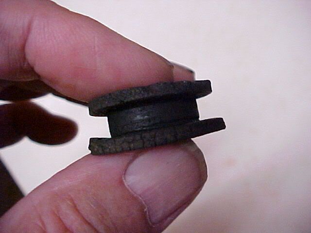

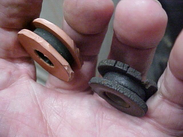

Here is a JPG of one of the two "ORIGINAL" Shift Bushing and Insulators:
Here is what it looks like on "edge".

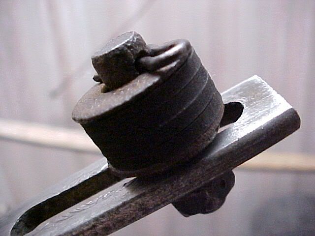

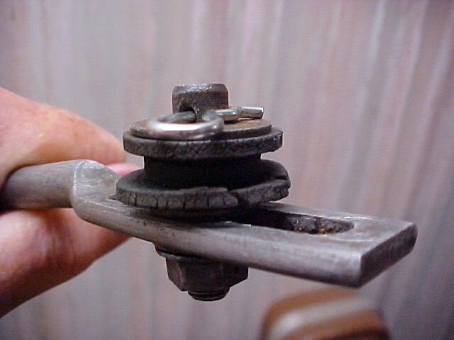

This is how it looked on the Shift Linkage:

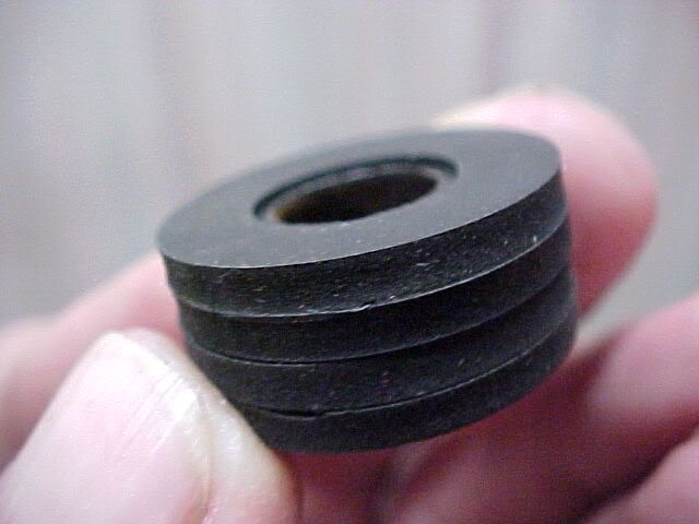

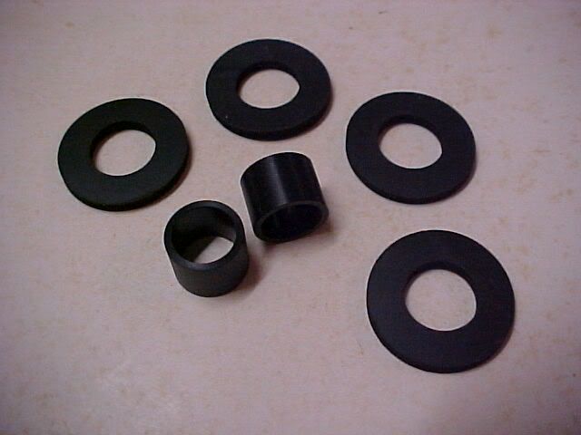

So HERE is what I got for $8.00 from GD:
Those are four rubber washers, and two small plastic tube segments. About $.02 at the local hardware store, and I paid $8.00 each, and got two of them for $16.00 total.
And here is what they look like when all put together:
Now this is just NOT going to work because there is no flange to hold them in the Shift Arm Hole! You see what I mean? Look at the ORIGINAL, and you'll see that it has a small center, and a larger flange on each side.
And here is what it looks like on the Shift Linkage:
Now THIS is NOT going to work. It isn't going to stay in the Shift Lever as it has no "flanges" to hold it in place. You see what I mean?

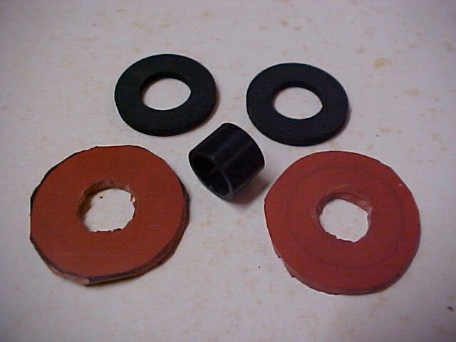

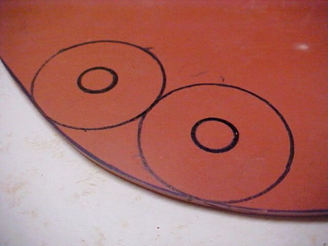

So HERE is what I did to "fix" that. I took another piece of rubber gasket material, and I traced onto it the outline of the ORIGINAL Bushing and Insulator. BTW, if those don't look quite right it's because of the wide angle lens and the hyper closeup shot. They are, in fact, both exactly the same size with the same size hole in the middle:
And this is a JPG of what the pieces look like in the set that I made:
And here is a shot of the ORIGINAL Bushing and Insulator (right), and the assembled Bushing and Insulator that I made (left).

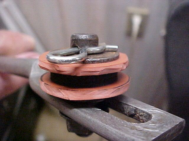

And this LAST JPG is of the Bushing and Insulator that I made on the Shift Linkage.

JC - What did you use between the two rubber washers
Hey 62XL,
There are two of the GD (Greg Donahue) rubber washers that came in the $8.00 kit. Those rubber washers are held together by one of the little pieces of plastic tubing going through their center holes. Then the two larger RED rubber washers are also held on the little piece of plastic tubing.
and how are the pieces held together?
They are held in place on the tubing, and then there are two steel washers, one on the side facing the slot in the Shift Linkage, and the other on the other side from the Shift Linkage, and then there is the little wire keeper that acts like a cotter pin to keep them on the post over which the little plastic tubing fits.
