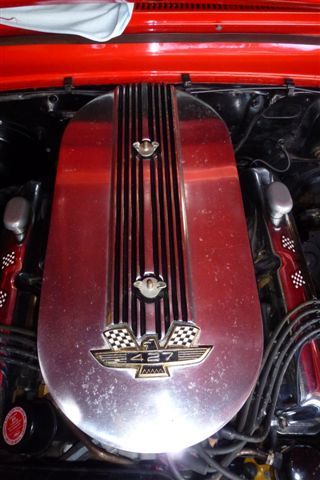

What has to be remembered (and I am having trouble remembering this) is that the air cleaner top with the 427 BIRD emblem was used on the 63/64 427 8V.

As a matter of interest, this is the top of Larry's original R code.
The question now is that I have seen many lids (online) which were cast finish, and lots of lids which are smooth finish.
I am fairly certain... :rolleyes: ... that all tops came through rough finish (as cast). The polished ones were done by the owner.
I also believe... :rolleyes: ... that there were only two styles of 3 X 2 top plates, one raised finned and the other raised fin with the area milled out for the BIRD EMBLEM (62/63 BIRD M-CODE).
I am now bracing myself for the usual correction from our resident board authority and security dude, DANIELLE... :frown:
Danielle doesn't come to this part of the forum, but this Danny does.
I reckon you are right about the tri-power lids. The Galaxie style and the T-Bird style, both unpainted.
But what about the tri-power on the 289s? Were they the same as Galaxie ones? But I guess we are talking about Mustangs here.....
As for the cast or polished tops on the 8Vs, even the restored R Codes I have seen have both types. This could get the chins wagging. :)
