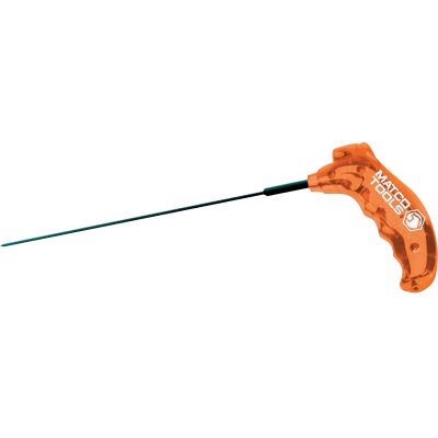

You could also check if it's "clicking" with a thin metal rod (ice pick, small philips screwdriver) and check for its vibration engine idling. Use one of the known good injectors as a baseline. You should "feel it clicking" (pulsing)...check #3 and compare with the KG injector....this is a crude way of simulating a fuel injector quick probe tool like the one you'll find at:
http://www.matcotools.com/ProductImages/md76400.jpg
Hope this helps.
