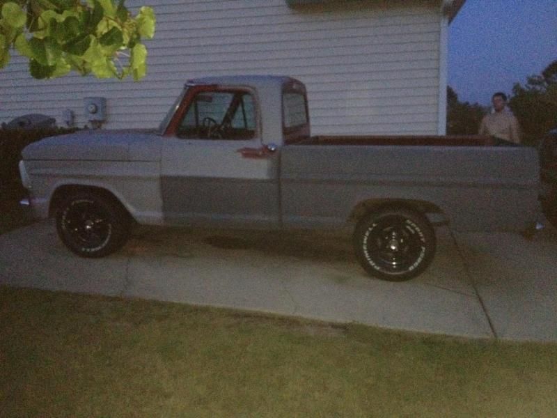

After some searching...Big Nasty is not a 69...it is a '71. Truck ran great when I got it but do have a slight smoking issue. I did the top end regasket and found a bad intake gasket leaking water into cylinder #4. After getting everything back together...The smoking got worse and now started going thru about a quart of oil a week. Needless to say that won't work...so engine is now out and off to the rebuilders. Hopefully we get it back soon and Big Nasty is put back on the road. Heres a fairly recent pic after we got the rear lowered.
For a split second I almost thought that was my old truck that I sold circa 1995. Mine was a 72, but had the early style grill, bed with no side marker lights, and so on. Mine was also gray but I had a Fox body Mustang hood scoop on it.
That's one of the only vehicles I regret selling.
