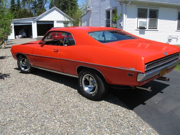

This coming Sat. I'm going to be looking at a '71 500 2dr. (non vinyl) formal roof car. I was hoping the brain trust here could give me some insight as to where these cars normally have rust issues. Any help you could give me would be greatly appreciated! Can't tell much from these photos, but thought I'd post them anyway. Thanks!:)

Thanks guys.
I found a rust issue with the trunk rail where the weather strip mounts, and there might be a slight cowl issue because after a rain, I had some drips coming down the side of my drivers side kick panel as well as on top of the rear wheel wells and on top of the drop offs inside the trunk. Beyond that, above the drivers side wheel arch has been worked, the door seam areas need attention, and the underside of the hood and trunk have perforation. The floors, torque boxes, trunk drop offs, frame, rockers, rear quarters all seem to be quite solid. Still has the original pinch weld along the bottom of the rockers, and lower rear quarters. I'm sure they'll be some other issues, but overall I'm quite pleased:) BTW, whoever did the finish bodywork and paint did a horrible job. Looks they painted it with a Wagner!
